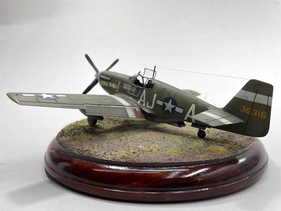

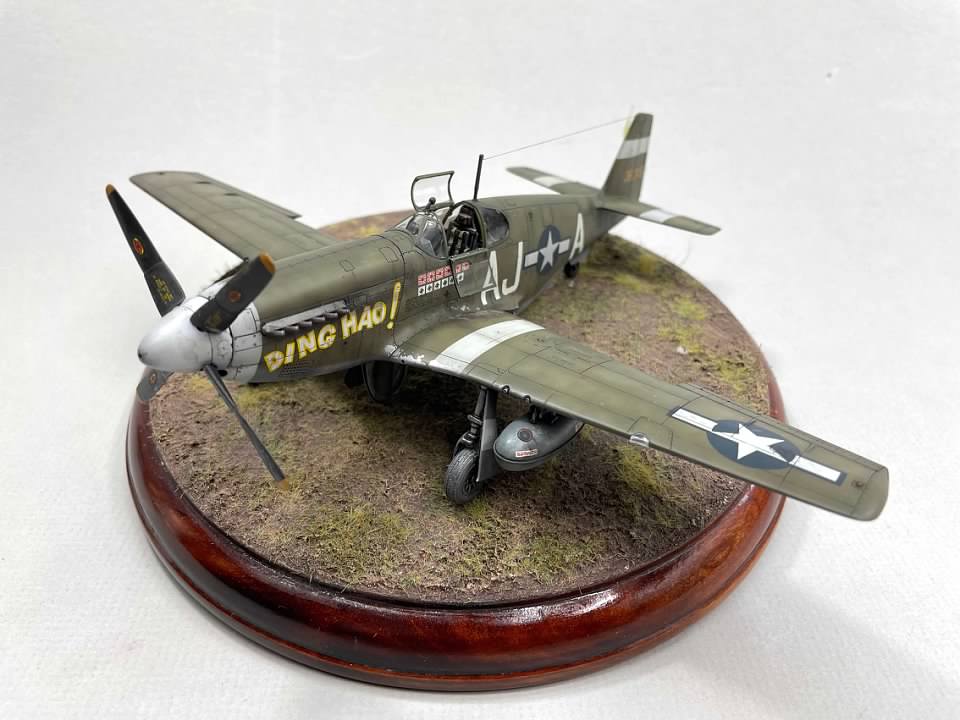

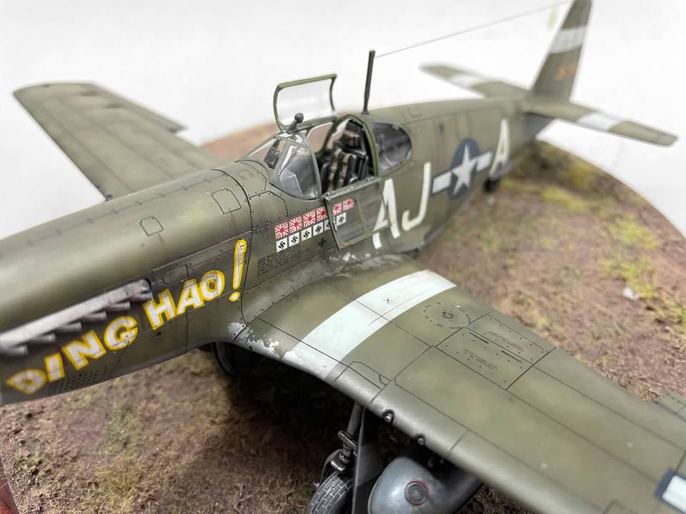

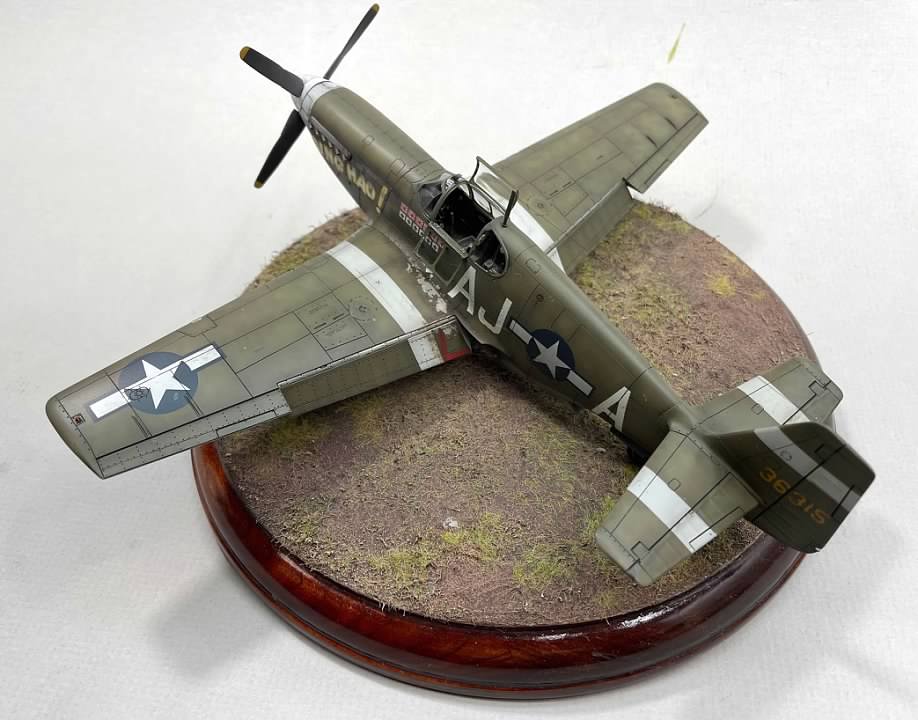

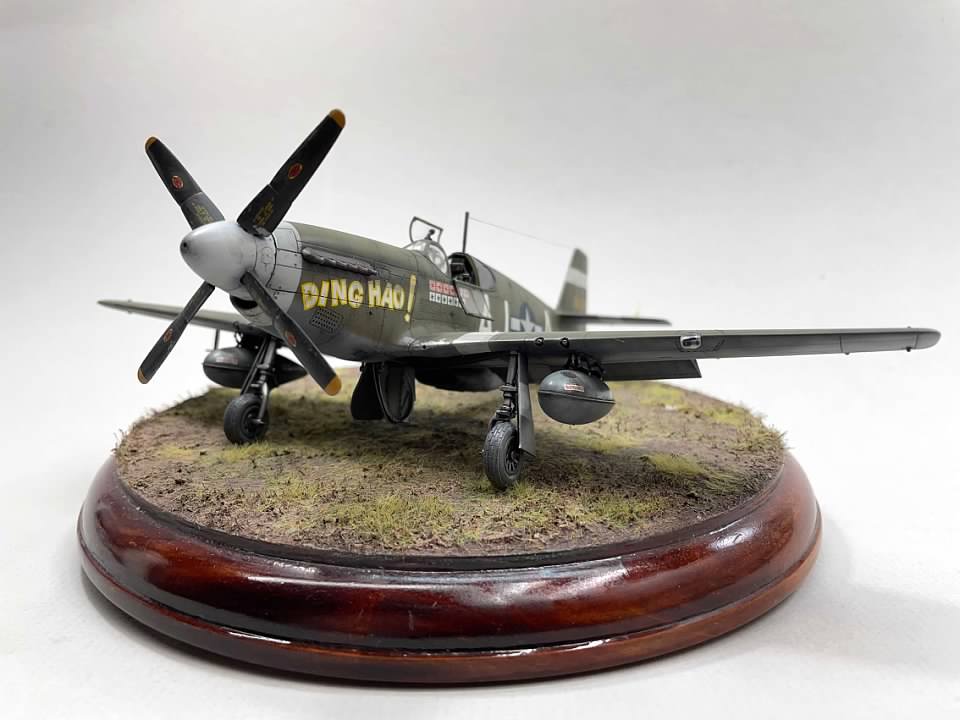

Hello, the P-51 bug bit me again so I had to drag out the good old Tamiya P-51 B. I went with James Howard’s Ding Hao of the 354th FG. On January 11th 1944, Howard lead a bomber escort mission when it was attacked by 30 plus German fighters. Chaos ensued and he found himself defending the bombers alone for over a half hour. He shot down 6 and even continued the attack after he ran out of ammo. His determination and bravery that day won him the Medal of Honor. He scored 12 kills, which included 6 in China while flying with the AVG. They don’t make men like this anymore.

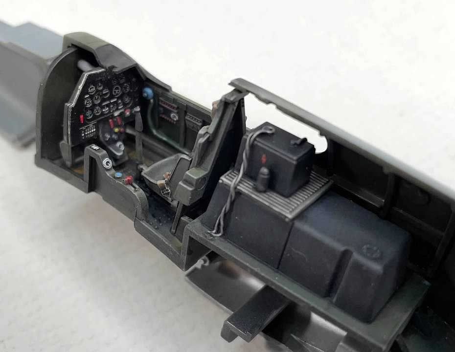

The Tamiya B is better than their D. It does however boast the same wrong metal curved cockpit floor that is correct for the A. I painted it to look like wood. Good enough. I used a Yahu instrument panel, which was quite nice. I added a PE seatbelt and Ultracast wheels I had in my stash. The 75 gallon tanks came off the Tamiya D as their B only comes with the 108 tanks. Paints were AK Real Colors. I used the hairspray technique for chipping. I’mgetting better at it. I’m liking it much better than AK chipping fluid, as the AK tends to pool on Alclad. Main markings were painted on with Montex masks. For Howard’s markings I used an old Superscale sheet I had which was complete garbage. The clear film desintergrated when wet and for the life of me I don’t know how I salvaged any of them. I ended up having to put the letters of Ding Hao and the AJ*A on separately.
That’s about it. Maybe eventually we’ll get a new B from someone. I actually prefer the look of the B over the D.

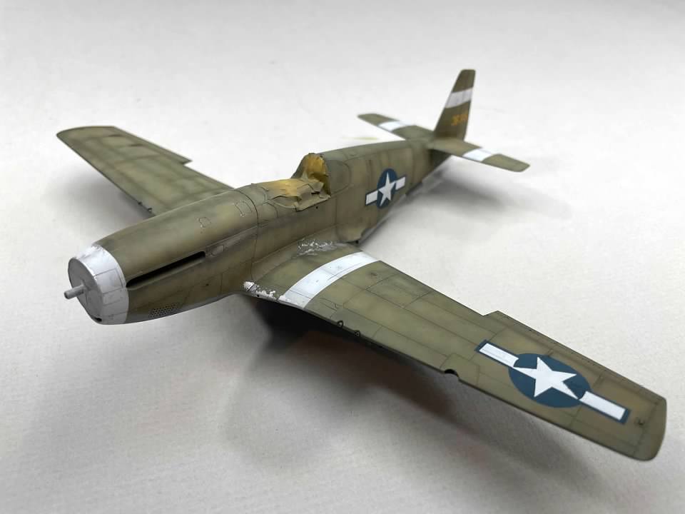

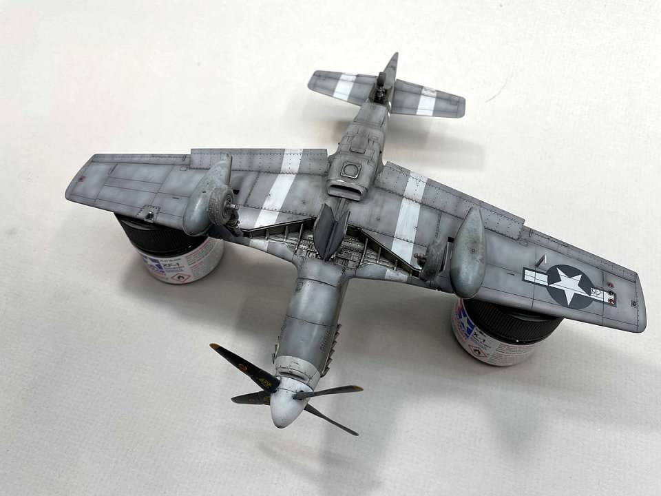

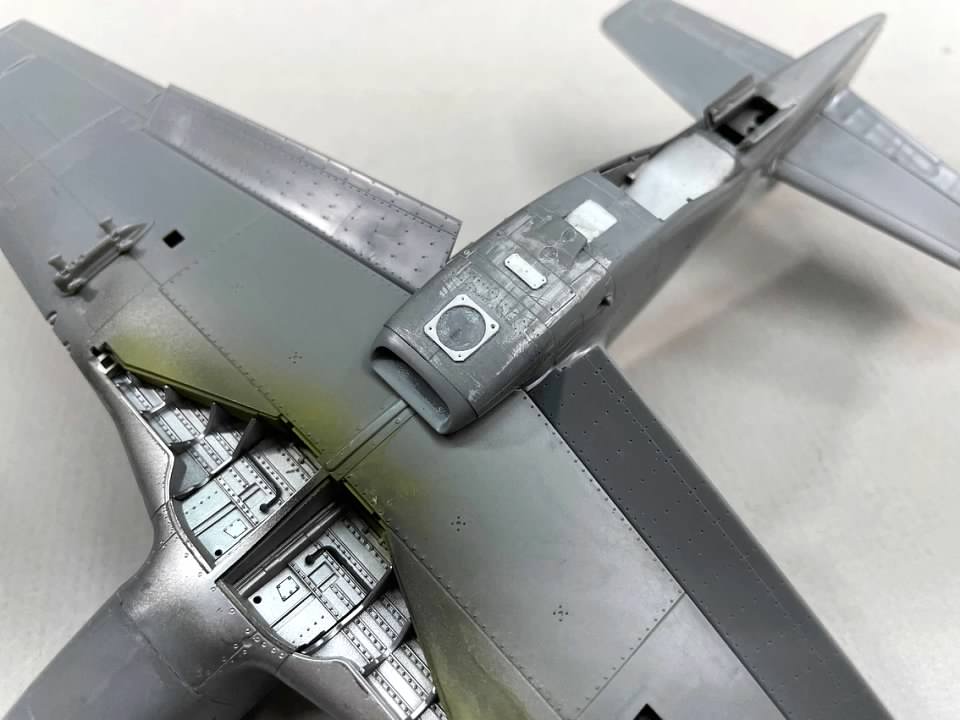

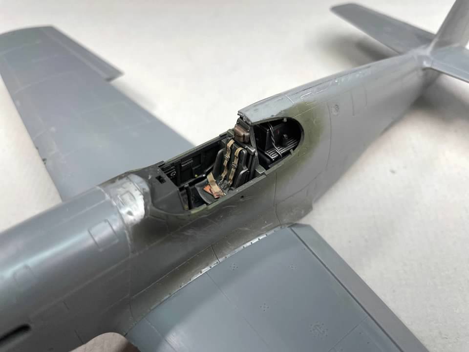

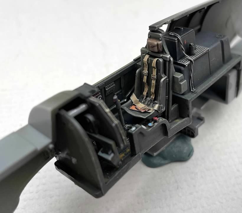

A few in progress…

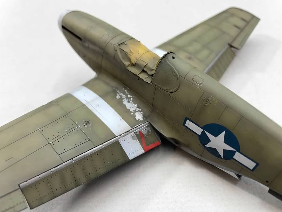

How I deal with this lousy fitting area.

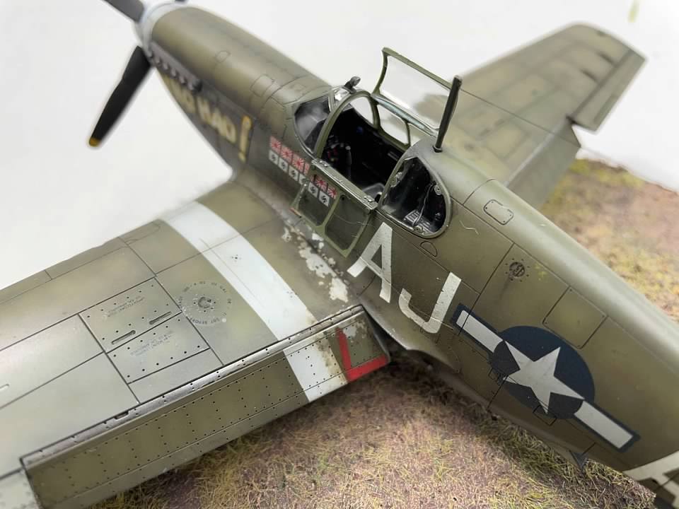

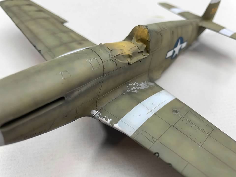

I was happy with the chipping.
