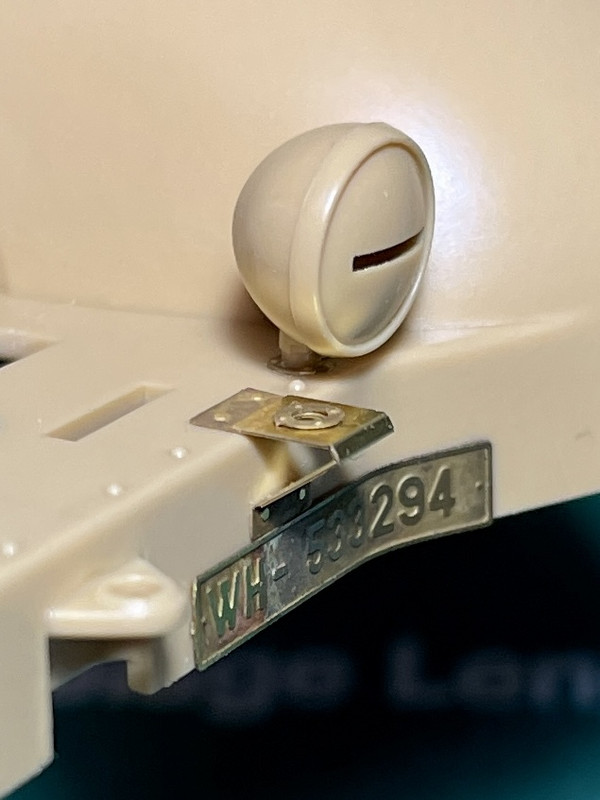

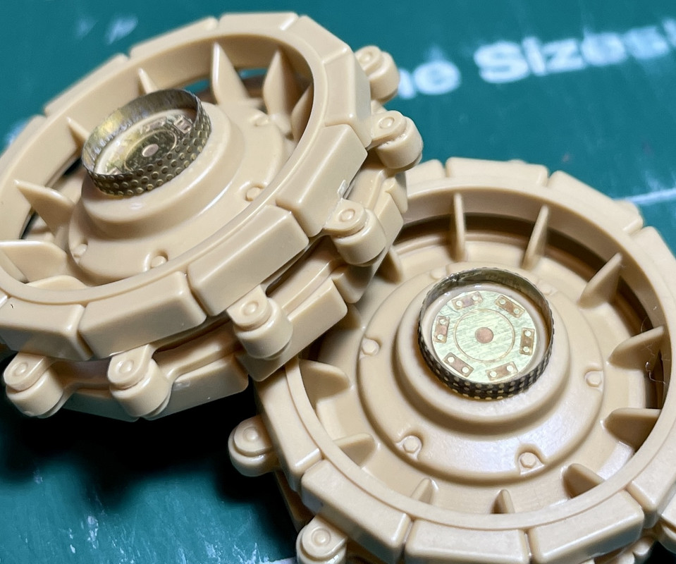

Ok, so did you use thin or super-thin CA with the baking soda?
Baking soda acts as an accelerant for CA, which could be cool.
Really hadn’t thought that the car could have been, more likley was a large scale R/C, makes sense. Even to this day I’m still just along for the ride when I watch it.
Totally AWESOME work so far on such an already beautiful kit. Tamiya has made this kit exactly as mentioned, many small models built into one. One of their best IMO, even better with the changes you have made.
That’s correct. I gave it a good wash of Tamiya super thin and immediately applied some baking soda. I gently tapped on the toothpick to eliminate the excess.
Thank you my friend. I think I need to find that movie and watch it again!
I’m thinking I just might!
I don’t think I have the skill or patience for that!
Chad: The PE improvements look fantastic!!!
Capt Mac: Thanks! Never thought about it but that makes perfect sense.

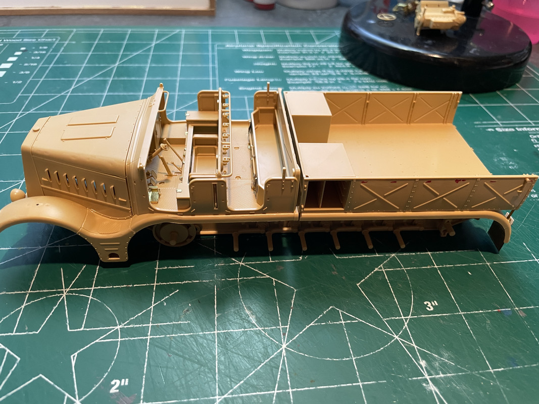

Awesome Bish thanks for the reply. Any progress MM?

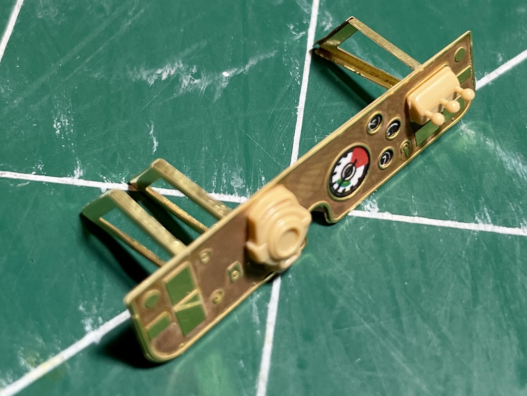

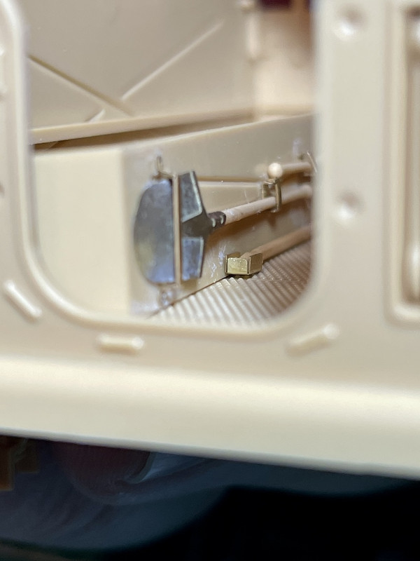

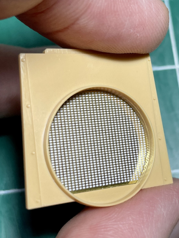

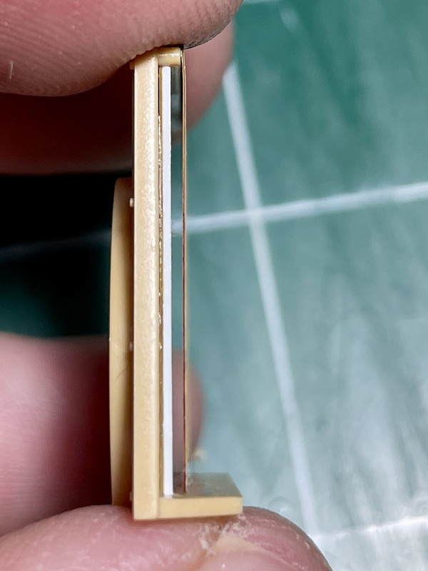

A little progress Armornut. Nothing too exciting, just trudging through PE.
Making the radiator is a slow process.
But, it really adds some zest to the front end.
Nice details Chad.
Oh yea that is sweet[:D]
Oh yeah, she’s coming along so nicely- the PE really looks good there!
Thanks guys!
