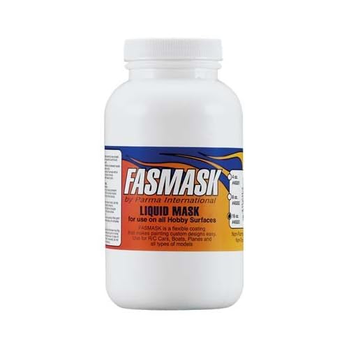

Any ideas on how I should mask the cockpit? I was going to tape it like I’ve done on other models, but I’m a little afraid to do it like this with all the different opennings and angles.
I was given a botlle of this stuff to mask a polycarbonate body for a RC buggy I was painting for a workmate, it works a treat on aircraft canopies too. Paint on a few coats and when dry cut out the frames with an exacto blade.
