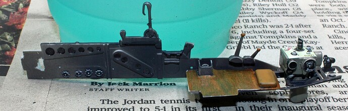

With an eventful weekend at the IPMS show and spending time with family, I didn’t get much time at the bench. But I was able to get out there this morning prior to starting my work day.
I’m slowly getting through the cockpit. I find myself constantly dry-fitting components to ensure that when I have put glue to some parts (not many as yet), everything remains in alignment to allow for successful completion of this area.
Today I finished the port side panel and controls. I also drilled out the back side of the instruments as the wiring is very visible through the nose cone. I built the fiddly foundation for the pilot’s seat. The radio equipment has been completed with 3D decals, and I have dry-fit the bombardier’s station to a side panel.
In the port side panel, you will note part of the thing is cut away. This was necessary as the instrument panel simply would not fit as it should. The entire port side panel is still a work-in-progress at this point.
The bombardier’s chair is also underway. The instructions call for installing the legs on the right side to the right side panel, but I am test fitting to drop that in once the main cockpit compnents are installed. I didn’t get the legs fully splayed to reach to the inner side panel to which the left legs are intended to attach to.

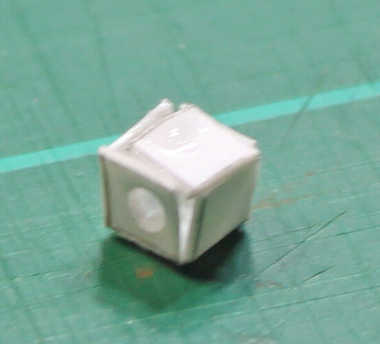

Some work last night and this morning, was to cut some sheet styrene to fashion a tiny box that Revell didn’t deem worthy of including in the kit but should have given how visible it it. I don’t know what it is exactly - a direction finder, perhaps? - but it mounts right in the forward most point of the nose cone. It has a single dial on it facing the pilot.
My approach was to mark out a 4-sided box, lightly score 3 of the legs of the individual squares (yeah, I love geometry), then gently bend it into a rough box shape. The photo with the clear nose cone piece was done last night, but it didn’t survive handling this morning. I basically crushed it. So I started over, as evidenced by the final 3 photos. I then cut out the remaining two sides of the box and drilled holes into them. I presume those holes are to allow ground crewmen access to the wiring of the dial.
I think this looks pretty bad. I’ll probably make another attempt at it, or maybe I’ll try to close the ugly gaps with some CA hit with accelerator.
That’s not bad for such a small box. OTOH, I would suggest using paper of a thicker variety (such as the type you sometimes get in the mail). Cut it into the shape of a cross and fold. But I’m not trying to build it, so take my suggestion for what it’s worth.
Good luck!
Gary
@GAF That’s not a bad idea.

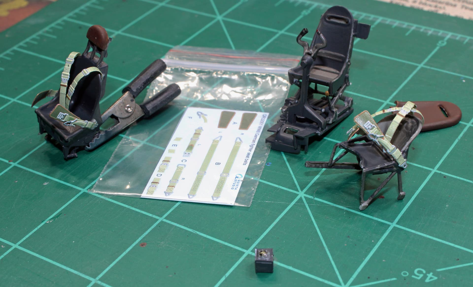

Got some decent work done today on the 88. I was able to rebuild the compass box and paint it RLM66. I also painted the seat cushion that affixes to the pilot’s seat. I then attached the 3D decal to the compass box, and started affixing the belts to the bombardier and radio operator’s seats. Also started attaching the straps to the pilot’s foot pedals, but I didn’t photograph those tonight.

This morning I completed attaching the strap on the foot pedals and continued work on the seat belts. The little pedal straps are difficult to get into position, but I found that putting a thicker blob of white glue on the mounting point helps.
One of the reasons that I prefer these 3D decal seatbelts over photo-etch or HGW is ease of installation. But even with these decals, the lap belts are notoriously difficult to get into position in such a way that looks natural. With PE I always seemed to get a belt sticking up in the air somewhat, which of course defies the laws of physics and gravity and such, and inevitably led to more CA than needed and a ruined paint job. My two attempts with HGW defied all my attempts to get those belts through the tiny PE buckles, so I’ve sworn off of those. Even with an optivisor, I just could not see those things.
