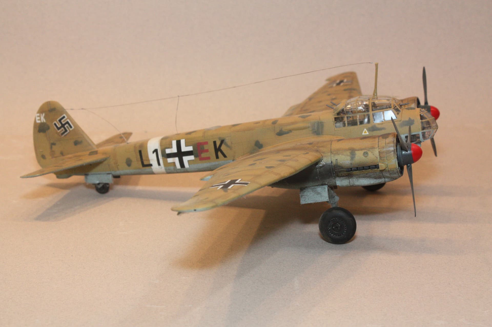

I have it built, man it was a chore to build. The part that holds the throttles didn’t fit on its intended place, so I left it off. I also suggest you get some aftermarket gear legs, the axles for the wheels will give up after some time because of the weight of the model.
It was also a chore because I wasn’t that patient back then and wanted to have everything built in a day. And also because the parts were all over the sprues.
Here’s my effort:
@Sturmovik Your Junkers looks good. If the part you are referring to is the one I’m thinking of - a long narrow console that mounts to the port side wall - I’m pretty sure that is at least one of the parts that resulted in my first attempt at this kit to fail.
Yep, that’s the one. Also, the rudder pedals were left off on my kit because they didn’t allow me to add the front glazing.

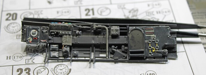

I spent the last couple of sessions at my workbench dealing with the starboard side panel. I’ve read that there are over 100 parts required to complete the cockpit. I can believe that without having actually counted the parts myself.
One of the photos has a bit of shine to indicate where some of the 3D decals are. I’ve found that the 3D decals really liven up a cockpit. And they are generally pretty easy to apply, with just a moment in water and a little smear of white glue. This panel is not complete yet, but all of the painting is done and all kit parts are attached. There is some wiring that runs along this side panel, as I recall from my previous effort at this kit. I’ll have to research where it should be, so this seemed a good stopping point for this morning.

Had a little time at the bench this morning before work, so I applied some flat clear to the starboard side panel to knock down the shine from the 3D decals. Then I got the camera out.
A couple more shots of the starboard side panel, with a newly added wire from last night. It is a length of 0.4mm lead wire painted first with flat white then with pure blue.
The ammo cartridges still need weathering with a silver prismacolor pencil, but the 3D decals are affixed to represent the leather straps affixed to enable carrying.
Finally, the completed bomb sight attached to the bombardier’s platform. I still need to paint the remainder of the wood paneling around that cushion, and I’ll probably paint the cushion a leather color.
