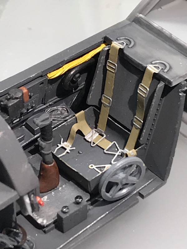

Most of the office is done. I went with the pe seat option since it’s more scale like in thickness. All the cannon breech detailed is hidden under the cover and unfortunately not visible but it is very well detailed.

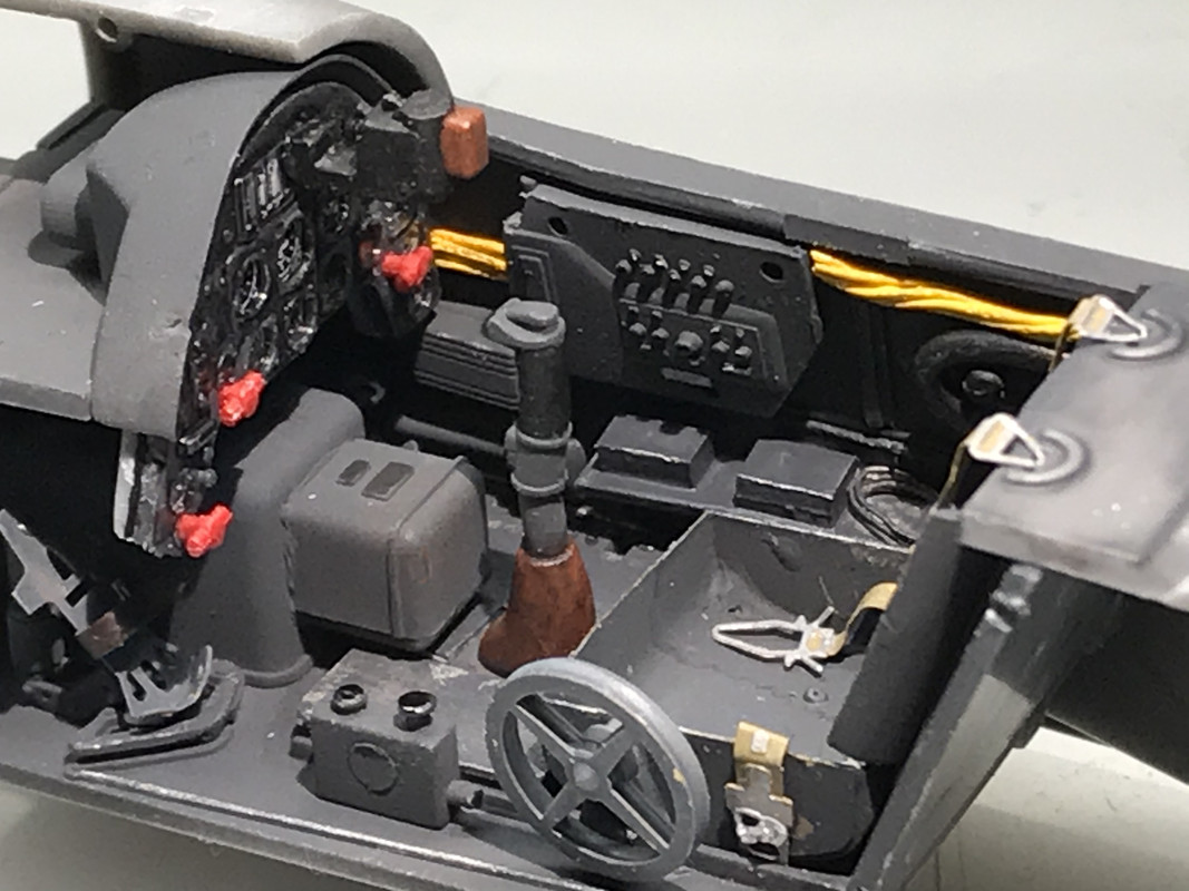

The IP is made out of several parts and will look very realistic once painted and assembled

The K pit is shaping up. Still lots more stuff to add but it’s moving along.
Next will be some corrections on the side walls for the correct K configuration.
So I’m working on the pit sidewalls and something just didn’t look right. Did a lot of net surfing for the K pit and seems Trumpeter included the G series parts as the K, no surprise here as I well know that companies often goof details.
Here is the pit with the included parts
After some corrections on both sidewalls. The right side sidewall panel is the wrong shape and was unable to undue the Tamiya glue securing it so I left it as is. Added some scratch built thingies and now looks like the Kurfürst office.
The cockpit is done. Time to move on to the engine compartment.

Very nice PJ. I’m loving all the provided detail.
Very nice looking cockpit!
Thanks for checking out things.
Thanks. I wish Trumpeter had included the correct pit for this variant but they like most model manufacturers like to take shortcuts.
