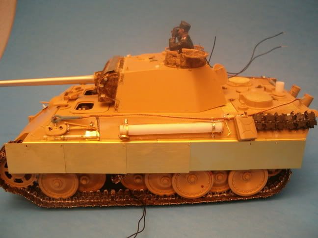

I affraid a little this step,but I decide demolish my Panther.Initially i ve planed to use only side supports,because bigger rebuilt be related to repainting.But its matter.
All fenders parts ,from Aber kit find on the table. I tried like said me Aber`s Owner to solder elements,instead of super glue.Especially for RC models that is stronger connection.
I decide to build up the connection between fenders and hull,especially that side skirts are by thicker brass,and at all finally its heavy. I added thin wire for stabilisation and stiffness.It s unvisible at all.
I drill holes in hull during tests.
Fenders without glue here
Now,skirts test montage. None the less no glue ,fenders are stabile.
I glue another parts from kit .Grills
Back-sight
Clamps
That`s all for now,today the right side

Im sick and no more progress last week.Around 3 rd wheel is thint thread,goes from the middle of track and there i done small unvisible kink.Its temporare denouement. I do resin ,individual tracks.

It looks good , one note however , on the mantlet sides , there are 2 mounting attachments per side ,one upper ,one lower for what I have no idea but they are there on the late panther G ,small strips of styrene with 2 holes drilled each will suffice here , both can be seen in this picture , I would also do some texture to the mantlet itself with some stippled Mr surfacer 500 …sorry about the picture quality .
