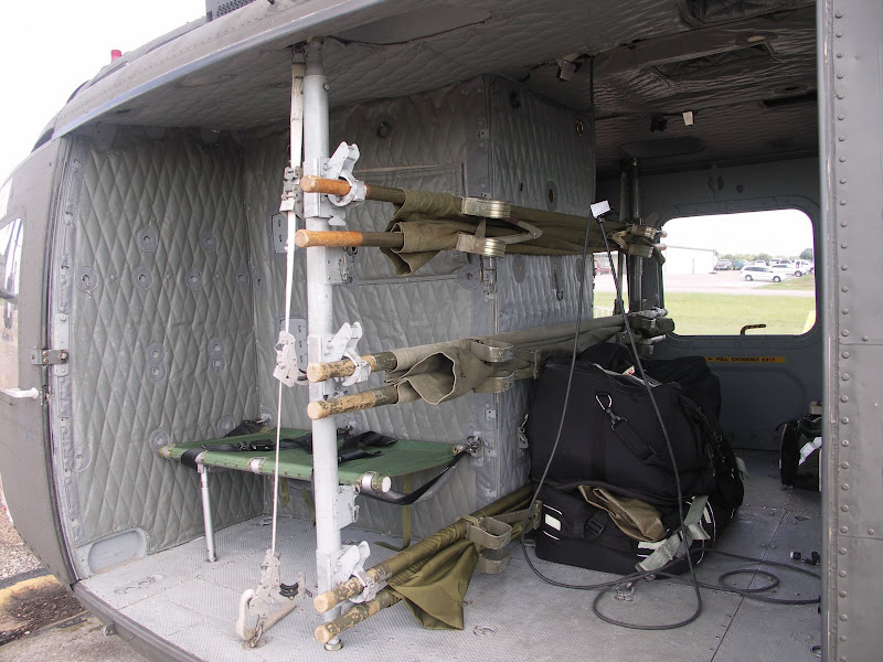

I don’t know of any used by civilian agencies. The UH-1B/Cs (Bell 205s) were used as a MedEvacs in the early days of Vietnam though. Usually, there were 3 stretchers along the back wall and a jump seat for the medic behind the pilots seats. It was not common to see both a bench seat and stretcher racks in them. There just isn’t enough room for both. Don’t go by Oliver’s build as a standard model. His skills are great and his helo looks good, but it would never be able to leave the ground with what he has inside. It would be way over max takeoff weight.
Here are some early ones.
The stretcher setup was similar to in the UH-1D/H below, butthere were hooks on the back wall and the poles were in the middle of the cabin, with the hooks facing rear, to support them. You can see the pole position above as well.

On the back wall is the fabric troop seat back, not flak panels. If you leave the troop seat out, you would need to remove this part though. You can see the fabric troop seat backs in red below.
