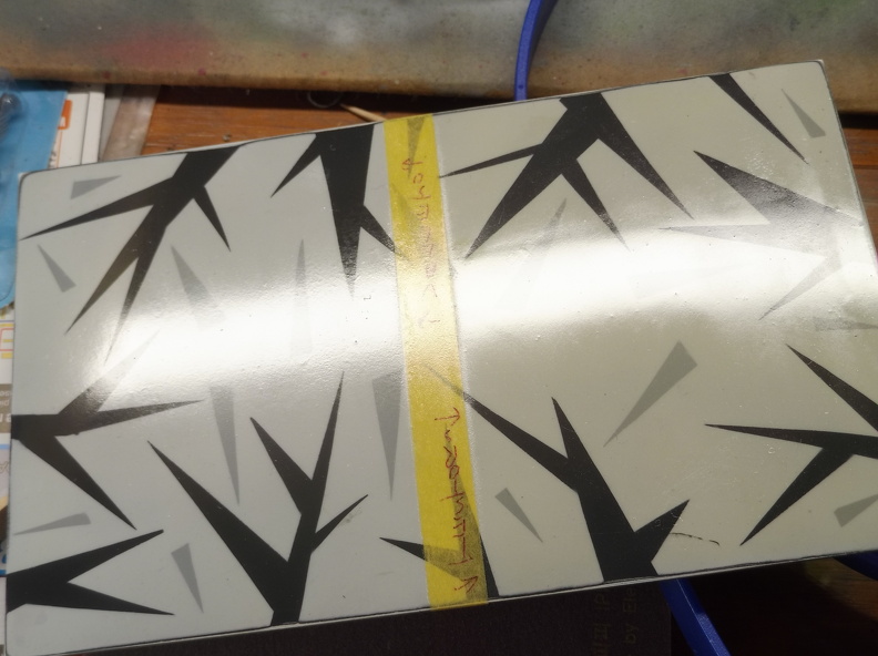

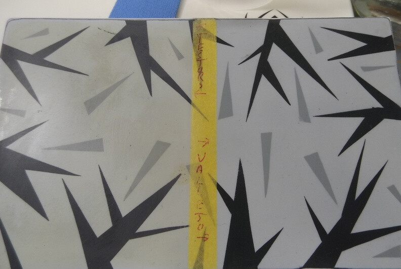

In general that’s been my stance when I get slightly irregular surface. No big deal. It adds character. However, I’ve been getting some significant pebbling. Where rather than looking like a subtle texture it looks more like bad paint. I am also concerned about silvering occurring when applying decals.
I’ve continued testing with the gloss coats and seeing some incremental gains. However, I am still experiencing challenges with larger scale repeatability. I’m to the point where I’ve started a lab book to better track the parameters and results.
Success! :partying_face:
:tada::confetti_ball:
Two different tests on different days with Pledge and able to get a high gloss sheen with no pebbling! Just lint caught in it during application.
The matte strip in between the two glossy parts was to make for easy demarcation between the two different test attempts.
I still haven’t found a method for Vallejo or Testors. However, the success with Pledge gives me hope. I was beginning to wonder if I was chasing a pipe dream. :face_with_spiral_eyes:

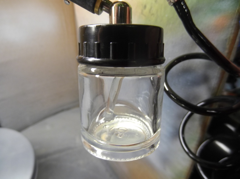

My siphon airbrush still has Pledge Floor Gloss in it from gloss testing done back in October 2025! Photo doesn’t really show just how much was in there.
It’s been sitting in my brush for 7 months! So you know I have to try to shoot some right?
First surprise, stuff came out of the airbrush first try. Second surprise, it went down pretty darn well. A little thicker than expected, but that’s probably due to sitting in my airbrush for half a year. LOL

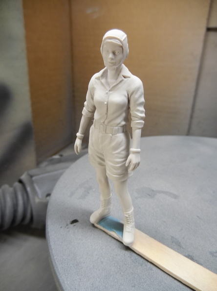

Primed the figure and this time it’s looking much better.
I may have gotten lucky and some of the filler stayed in the small gaps that were left. Overall this primer coat looks much better than the last. In a moment of annoyance I blue tacked her to the turntable in my painting booth. Only to discover I couldn’t move her to the paint dryer because of it. Ooops.
She’s been standing there drying since last night. I’ll drop her in the paint dryer for 15min this evening to finish curing the primer and I should be able to get started painting tonight.

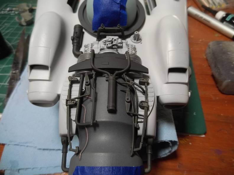

So the last night wasn’t the paint party I had originally planned. While the figure was curing I decided to work on adding the remaining greeblies to the bottom of the craft. Which ended up being the focus of the evening.
I’d been holding off for fear of breaking them. I can be rather ham handed.

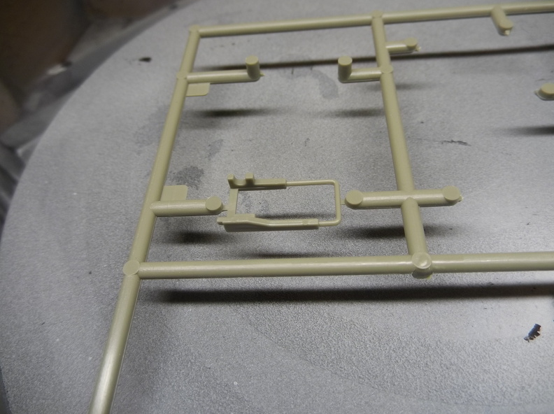

While following the directions to add all the greeblies I couldn’t locate one of the parts. :scream:
I was beginning to panic. Started digging through the box looking for parts and low and behold I find it. Still attached to the sprue. :rofl:
That was a close one! It’s part of the chain gun assembly. That’s the last bit of equipment that remains to be attached. Well that and the last two a-grav domes.
More to come.

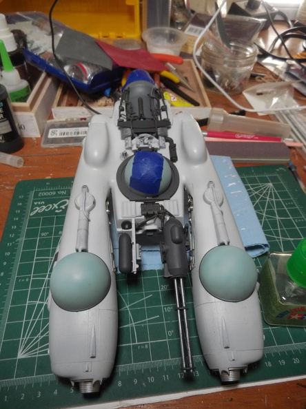

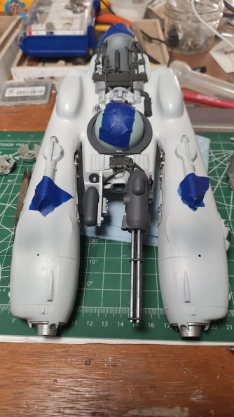

The adventure continues!
Chain gun attached!
But not really.
I took the photo while testing the fit. The chain gun was just resting on the attach points. I got called away before glue could be applied. And this my friends, is where the story truly begins.

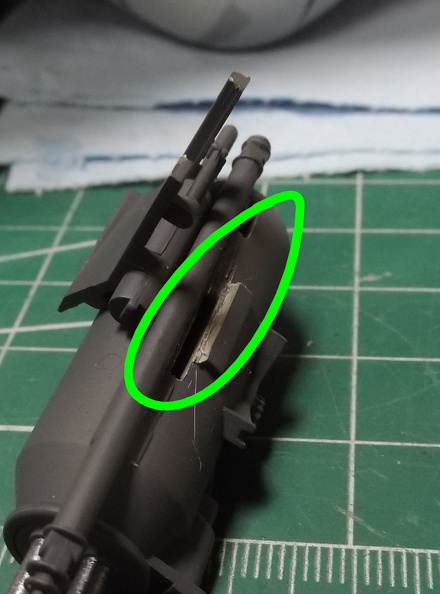

Coming back to the bench later that evening, work resumes on attaching the chain gun.
It’s sitting rather high when the tabs on the Falke are inserted into the slots of the gun body.
While I am trying to observe what’s interfering, this happens.
One of the two tabs that secure the gun pod had snapped. Not exactly sure how it happened, but it is supposed to be straight up and down. While I was checking the damage it came off the rest of the way.
Thankfully it is a good clean break.

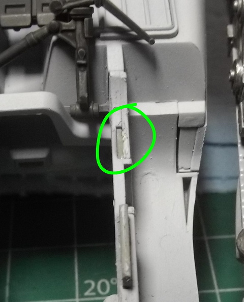

My first thought is there was too much paint build up on the parts. So I started carefully scraping the paint off of the tabs. Used the broken tab for doing test fitting and no joy. The tab isn’t fitting in the slot. I really should have test fit this earlier. :roll_eyes:

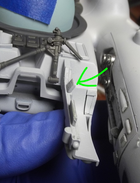

Out comes the hobby blade to carefully widen the slots. Shave, fit, shave fit. Hmm… It looks like it should fit, but it still won’t seat fully. Peer deeply into the recess and lo and behold I discover that melted plastic from gluing the two halves (the seam runs right along the slots) is protruding inside the cavity. Carefully reach in and shave it off. Test and… Success! The tabs now fit. Except…
The gun pod isn’t seating fully still. What is it now? :face_with_raised_eyebrow:

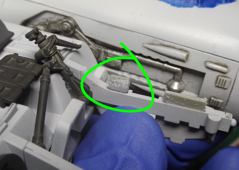

Turns out it’s this.
That large block of plastic won’t clear.
Out comes the scraper. Scrape, scrape, scrape. Does it fit, no. Scrape some more.
And of course in the process I put that nice big scratch in the paint you see above. Thankfully most of it will be covered and the rest can be attributed to the wrench monkeys who service the craft. :wink:

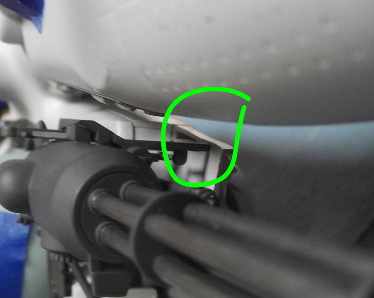

After much scraping and trimming it now seats fully. Except…

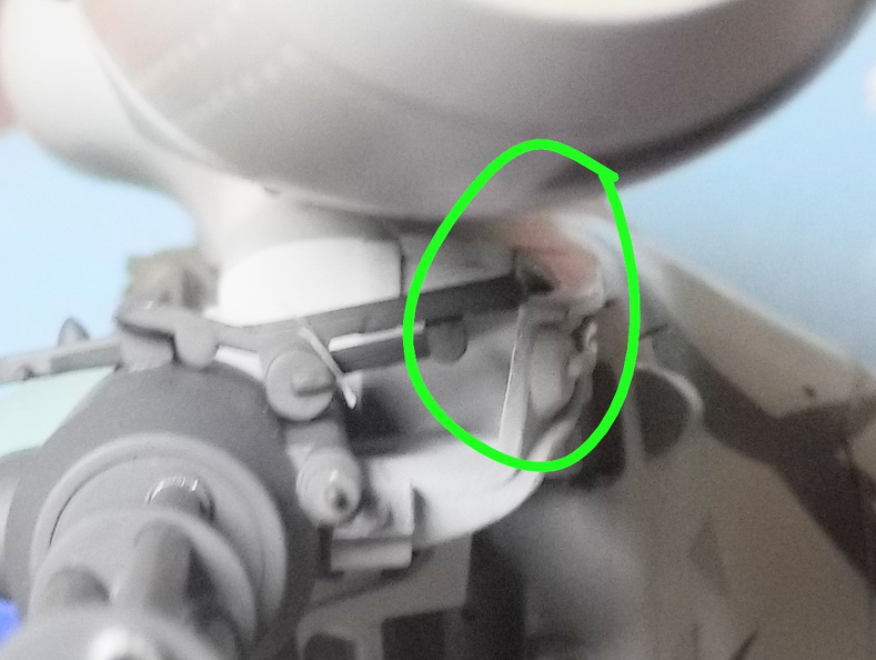

The parallax of the photo hides just how bad that part now sticks outside the cowling. It should be parallel.
Looking at the craft I can see that there is a slight twist to this portion of the cowling. Out comes the heat gun. Leaving the gun pod attached so I can tell when alignment is achieved, the heat gun is set to 312F, and hot air is blasted along the edge of the L shape you see in the photo. Applying gentle pressure the braces are slowly brought into alignment.
Yet another crisis is averted.
Foolish me for thinking attaching the gun pod was going to be simple and easy. LOL
The broken off tab still needs to be reattached and the pod secured. However, I’ve had my fill of fun and retire from the bench for the evening. All in all it was a productive session and I am very happy that I was able to address each issue as it arose. :slightly_smiling_face:

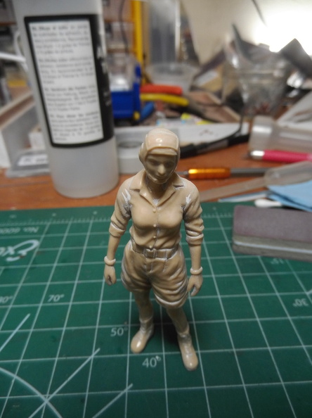

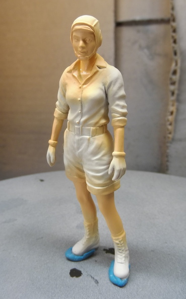

Started laying down the base flesh color for the figure.

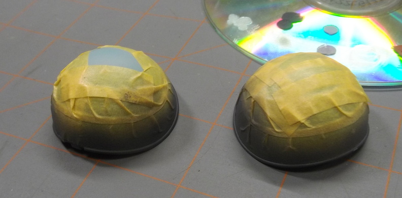

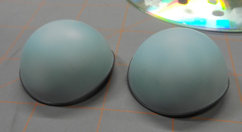

While she was drying I masked up the other two a-grav domes so they could get a slighty darker ring.
The dark ring around the edge will help hide the slight gap that exists between them and the fuselage.
Attached them and the chain gun to the ship.
It’s coming together nicely!

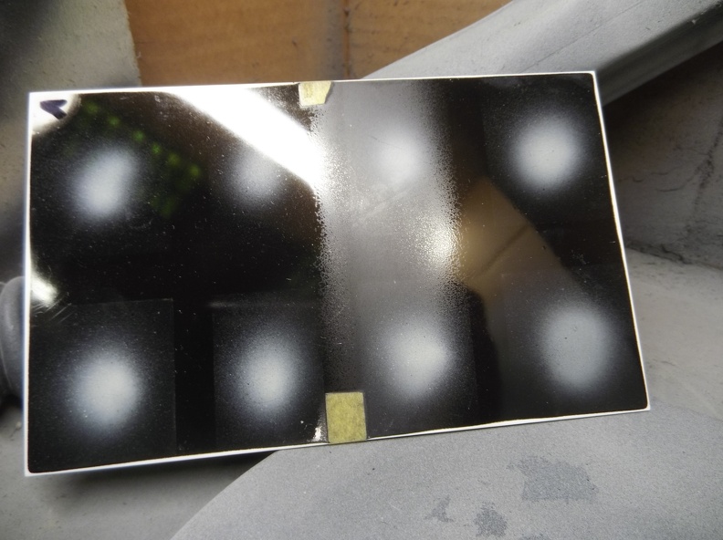

So the Pledge Floor Gloss on my test sheet suddenly went super yellow. The photo doesn’t show just how yellow it got, but you can get the idea.

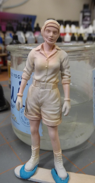

So I’ve been practicing with Vallejo gloss. I just applied the first coat yesterday in preparation for the decals. In between I’ve been working on the standing figure.
I continue to have tool related issues. I was applying a light pink to the figure to shift the hue of the skin when my airbrush suddenly spewed paint making half of it super pink. Rather than start over I just rolled with it.
I figure I can adjust the color by applying some filters to it.

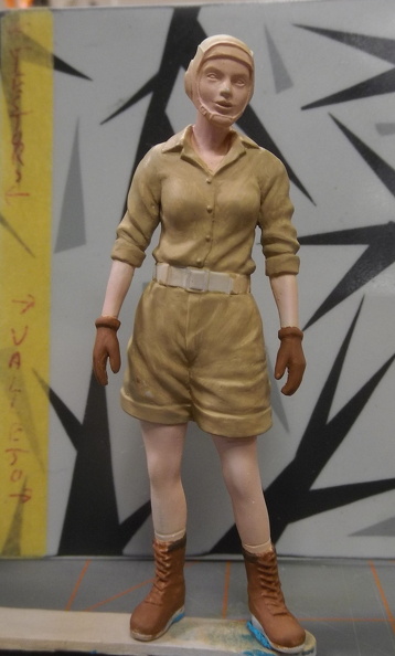

In the meantime I continue to block in the colors.
Sadly the figure took a literal nose dive off the holder and hit the concrete nose first and chipped off some paint. Again, will try to fix it in post. :slight_smile:
